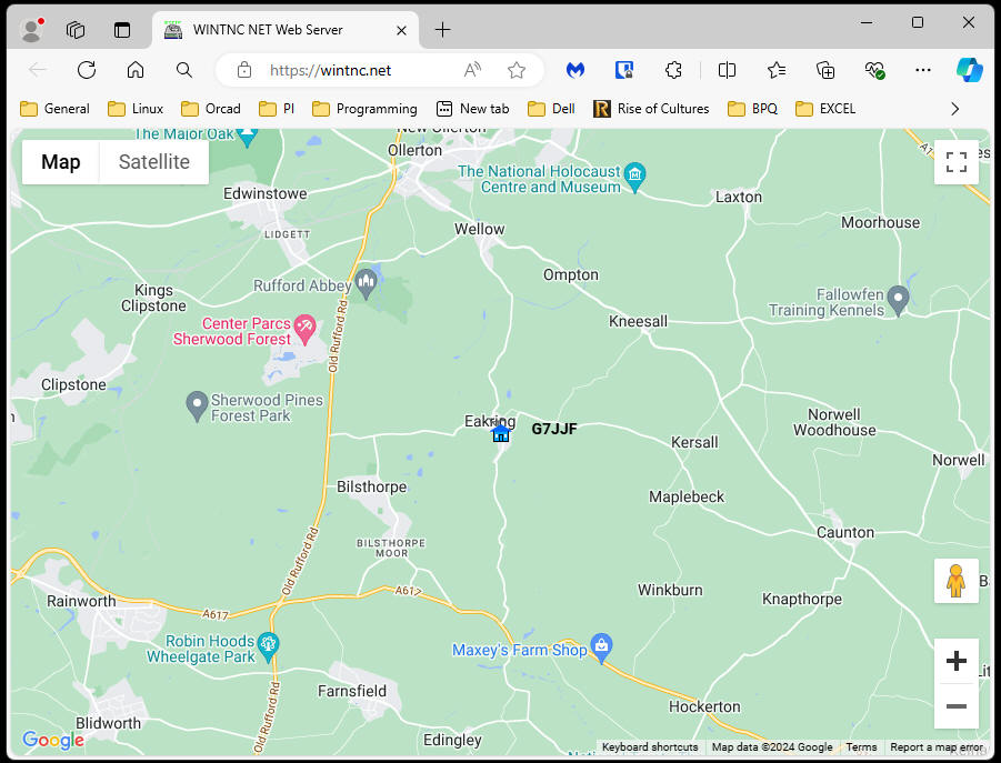

To display the google maps of active stations, simple press Alt-Y. If the initial screen is blank, click your browsers refresh button, normally F5.
Use the normal google maps interface to zoom in/out/scroll to see other stations. Hover over a house to see a small popup with the station last heard time. With the cursor over a house and the cursor changed to a pointing finger, click to open qrz.com showing info on the selected callsign.
